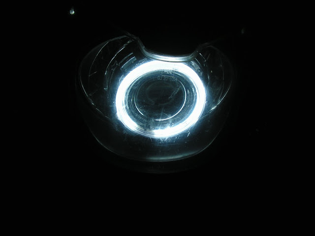

Originally Posted by pulsurge View Post
Thats a thorough, smashing and extremely professional job. Kudos! Pls pls pls pls pls pls share with us all the minute details of the job.
Thanks for the praises.
I've done a every minute detailed writeup here, come and see
[Photo Feature]: After Market HID Projector Mod for Pulsar 150 - xBhp.com : The Global Indian Biking Community

A pair of lenses made a hole of 12K on my pocket Its for a time being am keeping this on bike, want to fix it to my car when I get some free time
Am seriously considering to bring more kits to here for these mods on commercially.
